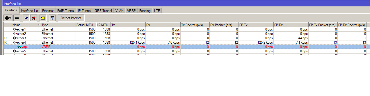

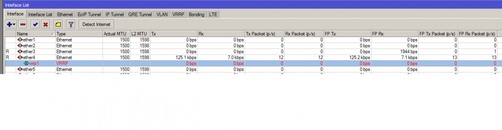

От този пример VRRP седи в червено

/interface vrrp
add interface=eth2V1 interval=40s name=vrrp1 priority=255 vrid=211
add interface=eth2V1 interval=40s name=vrrp2 priority=255 vrid=212
add interface=eth2V1 interval=40s name=vrrp3 priority=255 vrid=213
add interface=eth2V1 interval=40s name=vrrp4 priority=255 vrid=214
add interface=eth2V1 interval=40s name=vrrp5 priority=255 vrid=215

add comment=vrrp4 distance=2 gateway=3.3.3.1 routing-mark=V4r scope=20
add comment=vrrp5 distance=2 gateway=4.4.4.1 routing-mark=V5r scope=20
add distance=1 gateway=8.8.8.8 target-scope=20
add check-gateway=ping distance=4 gateway=1.1.1.1
/ip route rule
add interface=vrrp1 table=main
add interface=vrrp2 table=main
add interface=vrrp3 table=main
add interface=vrrp4 table=main
add interface=vrrp5 table=main
/ip route vrf
add interfaces=vrrp2 routing-mark=V2r
add interfaces=vrrp3 routing-mark=V3r
add interfaces=vrrp4 routing-mark=V4r
add interfaces=vrrp5 routing-mark=V5r
add interfaces=vrrp1 routing-mark=V1r
/system clock
set time-zone-name=Europe/Sofia
