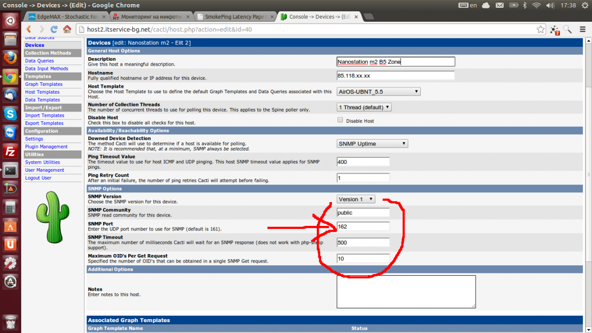

Мониторинг през snmp с MikroTik на Nanostation с Cacti
MikroTik:
/ip firewall nat
add action=dst-nat chain=dstnat dst-address=85.118.xx.xx dst-port=162 protocol=udp to-addresses=192.168.1.2 to-ports=161
add action=dst-nat chain=dstnat dst-address=85.118.xx.xx dst-port=163 protocol=udp to-addresses=192.168.1.3 to-ports=161
add action=dst-nat chain=dstnat dst-address=85.118.xx.xx dst-port=164 protocol=udp to-addresses=192.168.1.4 to-ports=161
Cacti:
